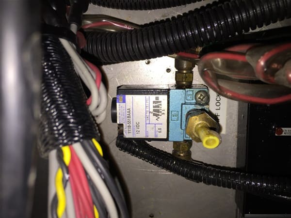

    I have a Valve leaking air out of the exhaust port that controls the Diff Locking rear end. I Called Prevost to order one, and they say they should be 24v. As you can see in the picture, mine is 12v. Prevost says Featherlite may have changed it? Does anyone have any info on this?

    That looks like a Mac Valve,a pneumatic distributor can probabally help you find it.

    Dick, no, I have a factory mounted switch which matches all the others that says Diff Lock. It activates the Electric valve which in turn by air pressure, activates the Differential lock.
    I was spraying the brass fittings on the valve last night, looking for air leaks, and I could feel air blowing on my hand, and it was leaking from the yellow tube, the exhaust port.
    David, the valve is located on the wall behind the chassis batteries towards the transmission side of the compartement.
