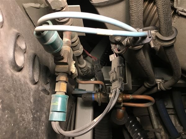

    Can anyone tell me what the function of these pressure switches on my dash air,they are after the compressor just before the air dryer. Installed new compressor,dryer, and expansion valve and refilled with 134a but will only cool to 63 degrees,see next post for pics.

    Low pressure and high pressure sensors. If 63 what was the differential. I have new compressor, dryer and expansion valve as well and the best we got was 59 with ambient being close to 80.

    One other item to check is the low-pressure bypass valve. It is in the picture above at the bottom left center. It has the copper tubing going in and out from it. It is used to prevent the system from cycling on the low pressure side by allowing hi-side gas to be inserted into the low side line to prevent this low pressure cycling. This device was added long ago due to the long a/c lines in the dash a/c system. It is normally set to begin allowing high side refrigerant into the low side line when the low side pressure get around 28-30 psi. If for some reason the valve is not closing properly or is opening too soon you keep the low side pressure too high and the system does not cool as effectively.

    I have ordered from Prevost and it is on its way thanks again.
    September 14, 2017 at 11:06 pm
    changed the pressure valve and system works great blows at 47degrees thanks again for the tip.
