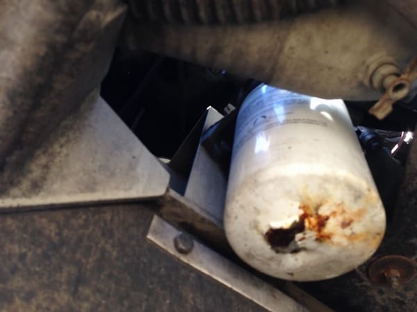

    This happened just today.
    About 2 hours out of branson, I stopped at a rest area and did a walk around. Saw this:
    It was the coolant filter. Looking up from the bottom, it had rusted through and was dripping at a rate of about 2 drops per second. Luckily we only lost about a gallon of coolant which I replaced with water at the rest area. The engine did not overheat.
    Although it seems counter-intuitive that a coolant filter, containing rust inhibitors, would rust out and leak, i’m betting that this rust started from the outside and worked its way IN.
    I called Prevost and they confirmed for me that I could simply shut off the filter using the two shutoff valves on top and not worry about it until I get home. Sure enough, it stopped the leak. Glad that it’s not a major problem, and it’s easy to reach from the rear door, just beneath the fan gearbox.

    October 19, 2013 at 8:35 pm
    Fred,
    How old was that filter? Don’t feel bad, I have a window that’s messed up too, but a screw came out of the linkage, I’ll fix it when I get home.

    October 20, 2013 at 6:16 am
    Fred,
    Your experience should be instructional for all of us. I believe the coolant filters which also maintain the SCAs in he coolant have to be changed every six months except when using 600,000 mile coolant. Since they are never intended to last a long time that is not a surprise. I don’t know of any filter that is painted on the inside for corrosion protection.
    BTW, my guess is when the coach cooled down you would notice it might need a little more coolant. Just a guess.

    October 20, 2013 at 10:53 am
    NAPA / WIX carries coolant filters in blanks , with pellets and without pellets based on the capacity of your system.
    NAPA filter catalog will have the information needed to get the right size. Ask to see it in store.
    The times I’ve seen the bottom canister rusted out have been filters in service way past there expected service life.

    October 20, 2013 at 2:05 pm
    This type of failure would concern me. Coolant is supposed to prevent rust and corrosion because of it’s additives which deplete in use; hence the requirements to change/check coolant every 2-6 years depending on type. If that filter rusted from the inside out, what does the rest of the interior of your cooling system look like? Has this coach been maintained?
    “Blank” filters contain filter media but do not contain additional coolant additives which are recommended only for certain coolant types.
    October 20, 2013 at 4:36 pm
    The bottom of the filter could have been damaged at some point thus accelerating the metal failure.

    October 21, 2013 at 4:43 am
    A highly placed Prevost employee once told me that owners rarely maintain their cooling systems so if the corrosion was in fact the result of lack of system care it does not come as a surprise.
