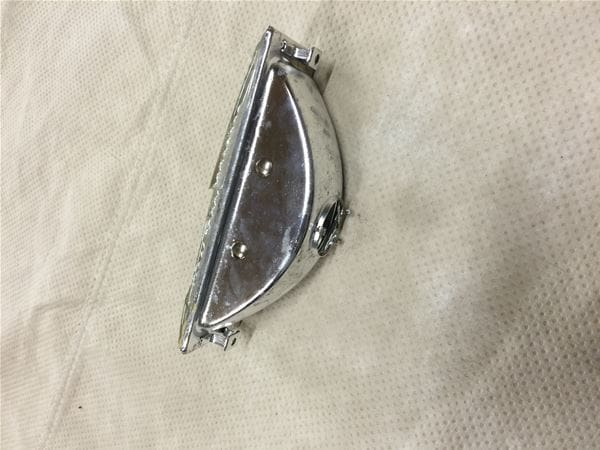

    Just wanted to show some differences of the Newell vs a Prevost…..
    the seam is totally split and there are none available so it must be repaired…
    You have to pull the bumper and pull from the rear of the coach probably double the labor of a Prevost

    Pretty yellow engine. Driver gets to legitimately wear a CAT hat. That is about the only advantage I see in a Newell over a Prevost.
    May 21, 2016 at 4:26 pm
    You can see that the weld didnt even come close to being centered on the seam. In some places it wasn’t even covering the seam. This means that CAC was leaking from the factory or very soon after being driven off the lot.
    On top of the bad weld in the picture, there is another weld on one of the mounts that failed.
    The up side is that this should be an easy repair for any capable welder. Wont take much to make it better then new. The other side of the CAC looks to be run pretty well on the center of the seam. Shouldnt take more then a couple hours of cleaning up the metal, running a new weld, testing it and then painting it.
