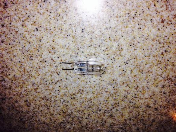

    I know this has been beat to death, but I’m fuzzy on just what 12v LED’s need to be purchased to replace the standard G-4 bulb. My concern is what will fit:
    1. Will the LED fit the recess of the light and still allow the pins to seat in the socket?
    2. Is there a polarity problem with the light requiring wire changes or can you get LED’s what are plug & play?
    3. Is warm white the correct color and how many LED’s are needed?
    4. We don’t us a dimmer, so that’s not important.
    5. Best place to order?
