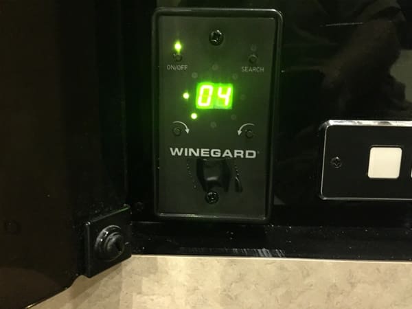

    I hated the old Concord antenna, never knew if it would raise, lower or turn and it had a mind of it’s own. So, off with the old and on with the new Winegard Razor. Easy fix once you remove all the batwing junk and you just reuse the single coax already in place. Backed the bus outside and got 22 stations, even as rural as Polk City, FL is located and most in HD. Total cost about 300 bucks.
    Sent to the junk pile.
    Had to make a plate to cover the original installation.
    Actually picked up 2 stations while in garage.
    This replaced the original batwing controller.

    It’s great Glens, you just let it search and your good to go. You can also run your cable TV connection to the controller, which I did, and all you do is turn off the controller and it passes your cable TV through.

    Also, does the new controller replace the electronic’s box “raising/lowering” the old antenna without any additional wires or connectors?

    The new controller that comes with the Razor is a direct replacement for the batwing controller. All it needs is 12v and your coax cables and you’re up and running. I didn’t do a plate to mount the antenna. I made a metal cover to cover the Marathon hole, screwed, siliconed the holes and then self leveling caulk. Marathon screwed the batwing directly to the roof, so I mounted the Razor the same way, it has 3 feet so you can position it anyway you want. It only weighs 4 lbs.

    Put the Razor directly on the roof forward of the cover plate with self tapping screws and caulk below and above the mounting hardware. The original coax was used in place, no new or rerouting of this. The roof antenna gets voltage through the coax, so there is no other wire for voltage. It was an easy install, it does a good job of auto searching and finding, and is user friendly. Cannot compare performance to the oem one, never used it.
    Now that’s interesting. I never realized that was possible.
    May 20, 2017 at 4:48 pm
    It’s not new. Some years ago I also installed a new satellite receiver with the same set up for voltage.
