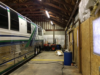

    The rafters in the center of the barn are 17′ from the highest point in the concrete to the rafter. That leaves a lot of unused area on the sides of the barn near the rafters. I decided to utilize it for a ministry office and a study..
    This picture is from the front of the barn down the side of the bus.

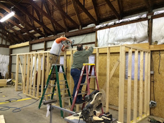

    A California Pastor friend was in Ohio visiting family between Christmas and New Years and he and my brother helped me frame it up in three partial days.
    We started with a very narrow room on the ground floor.

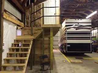

    I also tackled the hardest part for me. I built my first ever set of stairs.
    No rails yet and you will see why in a moment.
