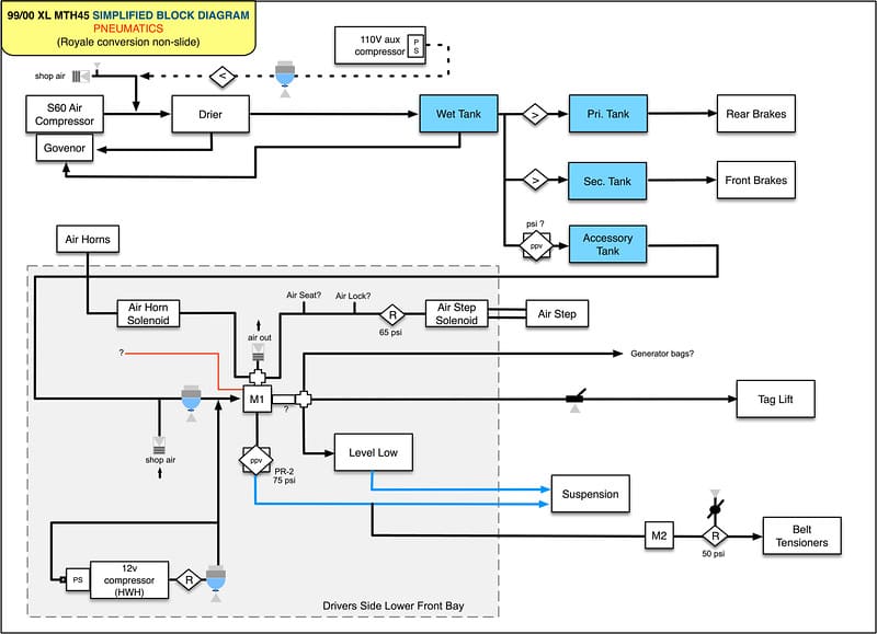

    Seems I’ve got a pretty significant aux leak, I go from 125 to 50 psi in about an hour. So I need a plan on how to troubleshoot this. I’ve read lots of aux air threads and this seems like a right of passage for a new owner.
    I started by trying to identify how aux air is plumbed on my bus and creating a diagram. I also referenced the pneumatic diagram for my particular bus along with the parts and repair manuals. Unfortunately I still have some questions.
    Here’s how my bus seems to be plumbed (diagram below).
    * the 110v aux air compressor connectivity is just a guess based on it’s location in the bus, 4th bay passenger side.
    * I do not know where all the check valves are, so where I placed them on the diagram is from past experience with other coaches.
    When I get to the bus tomorrow (after a week) I expect aux air to be at zero. I leave the aux air pump off.
    I expect the primary and secondary gauges to be at 90 psi.
    Any suggestions on a sequence of test to do? Does the diagram look right? Currently while in ATL I don’t have access to get under the bus but I think much of the aux air plumbing doesn’t require that kind of access. When I get back to TN I have a pit so I can chase things down more.

    Anyone know what the tiny red air line in my diagram above is for? I realize that per the color code standard this would be secondary air, but I’m not seeing what this would have to do with the rear braking system.

    From reading, it would seem there’s nothing magical going on with the air system, it’s just requires some modifications that allow for better isolation to aid in leak detection.
    Here’s my stab at the manifold and ball valve approach that others have used. Hopefully next summer I’ll have some time to do this.

    I put a check valve at small compressor line where it ties in up front and I never use aux compressor so I put in a shut off valve at compressor, Remember aux gauge is the same psi as wet tank there is no check valves between the aux and wet tank, But there is a PP1 valve on aux tank from wet tank, And can air leak back through engine compressor? That’s why I put in unloarder Kit on Bendix compressor. And does the dryer have a check valve in it to prevent air from coming back through engine compressor, I also replaced dryer

    Thanks Art. Roger that on the PPV between Wet and Aux, I show that on my first diagram above. I’m not sure what the crack pressure is – 75 psi?

    Just returned from a full day of leak isolating. Long story short, it started with one P2C fitting for the air seat but quickly became game of wack-a-mole with other P2C fittings. In the end to isolate I just disconnected a bunch of converter stuff and put plugs in the manifold.
    After that, my aux air loss went from 70 psi in 15 min to no noticeable loss in an hour. I consider that a small victory.
    So now I’ve got to figure out what type of manifold and ball valve setup to get for the converter aux air.
    Everything highlighted in the diagram is now disconnected.
