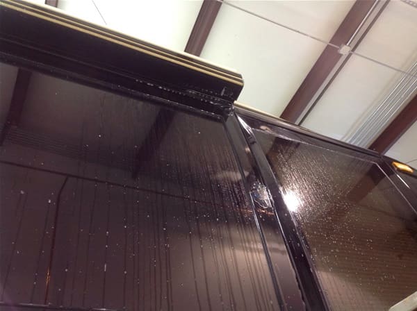

    another advantage to bus air coaches….finding those water leaks
    By hooking up a 24 volt battery charger to the evap blower, after unhooking it this way you don’t have to run the coach.

    It looks like he’s force filling the inside of the bus with air and soaping up the outside and watching for bubbles to form to show where the water leaks are.??

    another shot
    when you pressurize in inside of the coach you can then soap the coach in area where you have leaks inside

    Prevost does it this way to verify the leaks on the XLII stainless,thet just open the evaporator bay and crank the Detroit and turn on the OTR and spray bubbles,it is obvious where the leaks are.
    October 15, 2014 at 8:16 am
    That method works on any exterior leaks, including the roof.
    It requires opening the system to outside air instead of recirculating air. According to Tom when he used that method to check a coach he had the pressure created was so strong he could hardly close the door.
