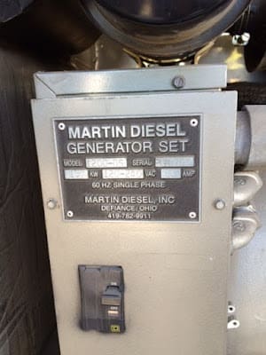

    The breaker on the gen is a 70 amp breaker, so if it tripped and you are plugged into shore power without a problem, I would assume the issue is with the gen….This could be as simple as a weak breaker on the gen. I would think that when you are ready you could run the gen, however pulling the cover and checking the connections etc on the breaker would be a good first step…

    Thank you guys. For clarity, Bryan, I removed the Cruise Airs in 2009 and added four roof airs. numbers 1 and 4 are on #1 inverter and numbers 2 and 3 are on #2 inverter. When I left the bus with the generator running I had on AC numbers 1 and 3, one on each side. Number 3 that runs off #2 inverter was still on when I went in and found the problem. It will run a couple of hours but not near as long as it did when my batteries were new in June of 2012.
    I can see what you are saying Bryan about the overcurrent issue and that the generator probably kicked the breaker first. That seems right to me but when it first happend I was sure the inverter was to blame.

    I would vote for a new breaker in Davy’s situation first.
