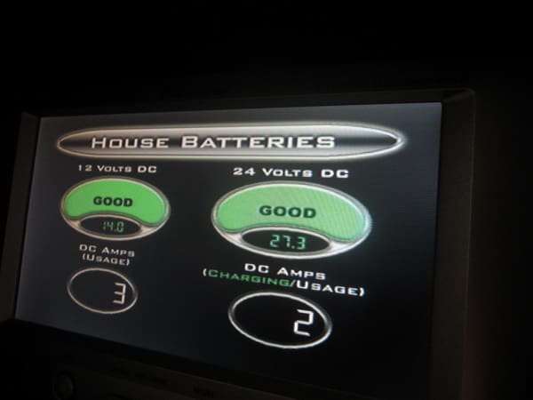

    On our last pre-trip the amp display on the 24 volt side was showing “261” and did not change. 24 volt display above
    read-out was normal number changing often. Picture was taken at the dash monitor small screen.
    After contacting Leon at Marathon tech service his response was “donut sensor in the house battery bulkhead. Not very common but they do fail . This sensor donut is the monitor point for 24 volt screen display.
    The new baby blue “donut” installed.
    Thanks, Leon at Marathon Tech service

    Update on screen watts readings…had the same issue as Al did, but on 12V side…was reading 261 to 264. Per Leon I replaced the donut for 12V, and since i was there the other 2 components, no joy…
    Stopped by Marathon, FL early this month, first the intention was to replace the donut…but already done, next was the DC to AMPS converter, located in the bedroom electric / electronic panel, Techlon 1113.
    Marathon had one in stock since 2004…replaced the old / original one and we were back in business, both readings are correct now.
