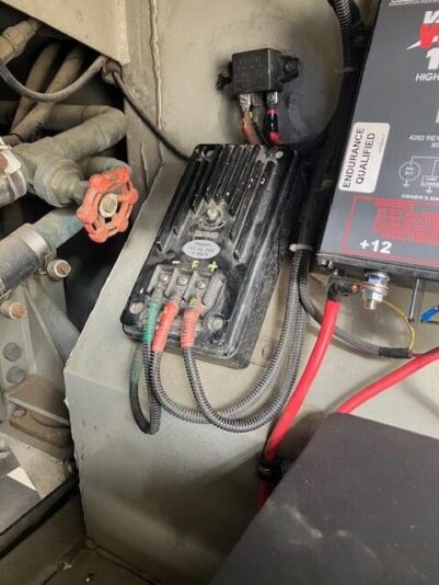

      If my DN 50 failed couldn’t you fix it, It also has a remote regulator so no regulator in my 12v DN50
