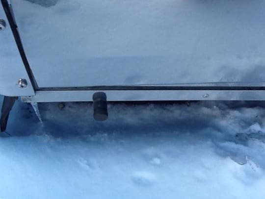

    Is the line depicted in the attached photo the air line used for supplementary brakes? It is located rear right below the engine compartment door. I would like to install a brakemaster system for my Honda Accord and just want to be sure where the air line is on my coach. (Sorry the picture is looking downward towards the snow)

    That looks like the macerator hose hookup, passanger side rear corner….

    December 13, 2016 at 3:51 pm
    Allan,
    If you do find an air line installed for supplemental brakes it will be very near the electric cable receptacle and it is highly likely it will be a fitting on the end of a small diameter black nylon tube such as a 1/4 or 3/8 size.
    The fitting in the photo is what Jeff says it is.

    That is a macerator hose hook up to drain the black tank

    Found the air line as Jon described. I feel like a dummy asking these basic questions. Thanks and sorry at the same time.
