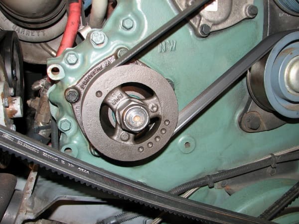

    My accessory drive shaft seal had been leaking for some time and when I called Williams DD, they said you can’t get the parts, you have to replace the entire assembly. So, I removed the drive and took a trip to Williams to see if in fact you had to buy the whole assembly. Low and behold, you can order the parts, but the cost is high. The seal and a bearing was 200.00 with tax and a rebuilt bolt on replacement was 320.00. A new assembly was 460.00. I went for the rebuild and all is well. There is no gasket behind the assembly where it bolts to the block and it has a big “O” instead. Be carefull not to nick the “O’ ring when installing.

    Over the years I have found it is a good idea to pull the belts and spin the idler pulleys and check for play in the drive that Tom pictured above. The few minutes it takes to do this is a small investment in time and may allow you to identify a failing bearing or play that can ruin a vacation trip. I have found and replaced bearings on idler pulleys that might have been OK, but they made bad sounds when I spun them and the small cost of a replacement bearing was going to be far less than a field repair.

    I too had a leaking accessory drive seal and replaced just the seal. Figured I would do this first and if the leak continued then I would go with the rebuilt unit. About $40 and several months later everything is nice and dry.

    I sure would have done the same as you Denny if I could have found a 400 seal, that’s the way to go.

    That’s interesting Tom because I went to W W Wiliams also but here in Hubbard. At first the parts man wanted to sell me the $400 new unit telling me that they no longer replace just the seal since they have had too many returns. Then he changed his mind and said for the difference in miles that I would put on versus a truck try the seal. If it doesn’t work then I would have to replace the unit. So far so good!
