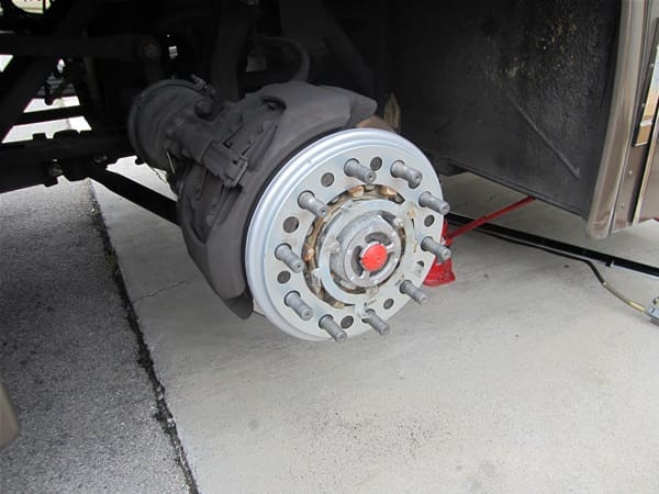

    Larry from Ohio with his 2002 XLII doing 365’s Michelin steer axle tire upgrade. The change over includes new tires, rims, and wheel studs replacement.
    Studs must be longer in length to accept the new rim. Rim must be replaced to accept the larger tire.
    Tire and wheel removed…original studs inplace
    New 365 Alcoa rim…New very rare and priceless Michelin 365 tires on property and secured in vault until needed.
    Jeff puts the mighty hammer and drives each stud loose. I watched as his aim was on target for every stud.
    Short studs removed
    Longer studs go in from back side. Use old lug nut reversed tightened snug then spin on another nut, with impact
    engaged the new studs are pulled into place locking them tightly in hub.
    set up install new longer studs
    new studs pulled into place with 3/4 drive air impact
    New extended length studs in place

    October 4, 2014 at 10:53 am
    For those not familiar, you have to change out the stud pilot to hub pilot as shown in the photo’s. The new 365 Alcoa wheels require hub pilot studs and nuts.

    October 4, 2014 at 3:10 pm
    “stud pilot to hub pilot” … explain the difference. I’ve seen the reference before. Can’t see the difference in the pictures.
    October 4, 2014 at 9:14 pm
    Dick,
    Here is the differene..
    October 5, 2014 at 5:48 am
    Jon, yes the coach was well supported and safe….
