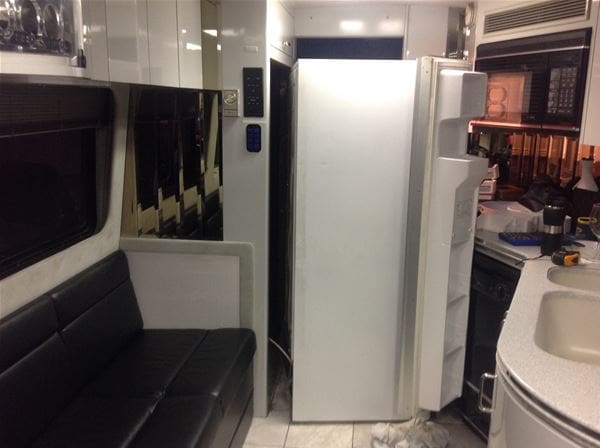

    So I need to change the front passenger side window after it received a rock last week so I guess this would be a good time to replace the 24 year old fridge but I am having a tough time finding one to fit the opening. My current fridge is 33″ width x 66 5/8″ height x 30″ depth with handles it’s the depth that is against me. Has anyone else had to replace a similar sized fridge? My max depth is 27″ without doors and 31″ total with doors and handles. Any suggestions will be appreciated. Thanks Jeff

    June 26, 2017 at 8:29 pm
    Do a search for Kenmore – Fridge here on the site and you will see posts about the Kenmore several of us have used due to dimensions.
    We love ours, works great.. Kenmore
    Here’s the dimensions:
    Dimensions and Capacity:
    Weight :
    220 (lbs.)
    Freezer Capacity :
    7 (Cu Ft)
    Overall Capacity :
    20.6 (Cu Ft)
    Depth w/ Handle :
    29.75 (in.)
    Depth w/o Handle :
    27.5 (in.)
    Height to Top of Case :
    68.875 (in.)
    Height to Top of Hinge :
    69 (in.)
    Depth w/Door Open 90 Degrees :
    50.438 (In.)
    Refrigerator Capacity:
    13.6
    Width w/ Door Closed :
    35.5 (In.)
    Depth without Door :
    24.5 (in.)

    June 26, 2017 at 10:06 pm
    Kenmore 51789 is the same one I used to replace our Amana. You should be looking for “counter depth”. They’re out there, but tough to find. Are you close to ETLC? If so, have it drop shipped to Jeff and have him put it in. They are very, very efficient at both the window and reefer swaps (read save $$$$).

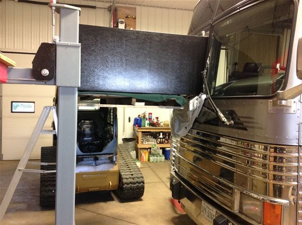

    June 27, 2017 at 4:25 am
    When I had to replace the Amana in a previous coach I learned how to quickly sort through the various sites and read the dimensions which was the first criteria.
    If you are bringing it out and the new one in the safest way is to remove everything in its path plus space for people to walk. I pulled the table and chairs, the sofa, the passenger seat and then used shipping blankets to cover the dash under the window, as well as the floor. I stripped the new and old refrigerators of everything I could remove to minimize weight and avoid parts from falling off.
    There is no substitute for a fork lift or hoist and 4 people are the minimum.

    June 27, 2017 at 9:21 am
    Thanks Jon for the good advice I will post pictures of the progress. Now I need to track down a Kenmore 51789 hopefully I can find one in Canada or I will have to head down to Sears in Great Falls MT.
