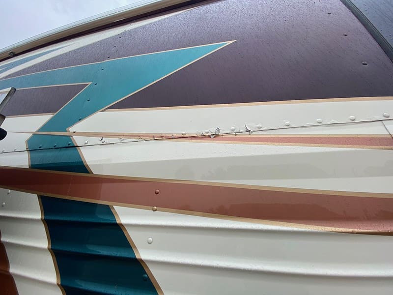

    I’ve been looking for a high quality XL for going on a couple years now, and one of the things that continues disappoint me how every XL I’ve looked at has paint bubbling at the belt-line. Do they all have this problem?
    Here’s a pic from a 99 Marathon always in AZ stored in a climate controlled hanger for the last 15 years.

    My 97 CC does not have this issue. The Sikkens paint still looks like new even though the bus sits outside under a large walnut tree while parked at our summer home in Kerby, OR, for a little more than half the year and outside on our lot at The Palms RV resort in Yuma, AZ, the other months of the year. We travel a lot so it is also outdoors in lots of places all through the year.
    Paint lifting like you show is likely the result of less than perfect preparation prior to painting. Are you sure you are looking at factory paint and not a re-paint?

    I have some of that on mine and it came from Yuma parked under a cover

    Aluminum is one of the hardest materials to paint because surface preparation has to be done just right. The slightest flaw in surface prep allows aluminum (which is highly active) to begin to corrode and that corrosion will travel quickly beneath the aluminum and cause the paint to pop.
    There is a mistaken impression that aluminum does not “rust”, but it forms white surface corrosion very quickly and only a very good pre paint surface treatment can insure a good bond between the paint and the aluminum beneath it.

    You can call James Stallings at Xtreme Paint and Graphics about Prevost and aluminum painting and prep. The prep of an XL rivet bus requires each and every rivet to be detailed thoroughly.

    I’ve always assumed it was galvanic corrosion due to the joint where the aluminum and stainless butt-up to each other. I’ve had some aluminum cruisers that had stainless stanchions and those seemed to bubble the same way where they mounted to the aluminum deck. Just thought Prevost with their engineering depth would have found a way to isolate the two.

    It is about the pre-treatment. Maybe some galvanic corrosion may contribute, but that is not the primary cause.
    Over the years my factories had powder coating systems installed, including the last one I owned that had the Detroit Series 60 engine finishing system, and I would rather eat bees than put a finish, powder coating or otherwise, on aluminum because of the difficulties associated with finishing.
    The car manufacturers that use aluminum body panels go through a lot of steps to pre-treat and apply a finish that will adhere forever.
