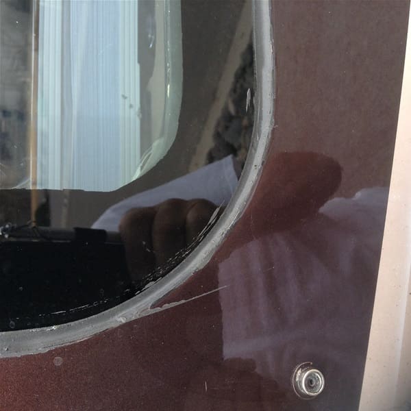

    Recently I had a bad experience with Suncoast Designs glass company. Here is the transcript of the conversation with their manager. You can draw your own conclusion. I’ll only upload one photo because of size. The compound will not come off the paint without further damage
    The photo turned 90 degrees. You can see the same compound on the blind in the background. Obviously, there is no way to get three quotes.
    Please start reading from the bottom (the start of the correspondence).

    Cement on my blind, peeled paint, chipped paint, sloppy finish on the sealant, etc.
    Very sloppy and damaging workmanship!

    Picture shows poor lay down and probably cheap tape used.and uneven line next to paint. With the tape available in the market today it should be razor sharp with a perfect curve right on the crown of bus panel. The rough texter of the sealant shows the installer used the final smooth out both ways which gives you a lumpy surface and bleed under tape line.
    Proper tape lay down starts with a 100 % clean surface. Bleed can be caused with just the normal dust on a paint surface. That’s all it takes.

    This is how I see it, the work in the pictures is shoddy. There is no doubt about it. Everyone who owns a Prevost bus is a “high end client” and I would think their business would be of the utmost importantance. The internet can destroy your business and what I mean when I say internet I am refering to sites like Prevost Community. I am sure they have a facebook page, Google page, and web site where customers who are looking for services like theirs are looking them up and would rather not have negitive comments made there. Bad reviews will KILL a business. Today is a different kind of day, and people look you up before ever doing business with you.

    Glass replacement of the type shown is quite easy, and there is no excuse for the lack of care shown. All Prevost owners should consider if they want to risk the same experience.
