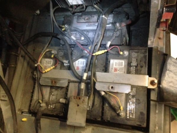

    1998 Liberty.
    Not able to start. Dash gauge shows nothing on 24 v. Tested the 24 v at the cut off voltage terminal and it was 9.43 v.
    Assume it is a battery issue – four yrs. old. Have x4 batts. in serial and parallel for both house 12 v and chassis 24 v. Anything I should do besides turn off the cut offs for 12 and 24 v. Do I need to turn off the inverter before replacing the old batts? Other suggestions?
    Photo enclosed.

    Wave, you really have me confused. You show chassis batteries. You mention a very low voltage and that the coach will not start, but then you talk about the house and having 12 and 24 volts as though the house is affected by the chassis batteries.
    On a 98 Liberty you may have a charger above the chassis batteries. If so turn on the switch in the panel to see if the batteries can be charged. You don’t provide any information about if the batteries were not used for a long time or if the low voltage is something that happens quickly, as in overnight.
    Not clear on what the house has to do with starting? If they are low the generator or shore power to the coach should enable the inverters to charge the house.

    House side seems to show 13 v but nothing on the chassis. It is my belief that those four batteries are all there are except one to start the gen set so I assumed two of the four were chassis. The coach has two 4k inverters . Do you think there are other batts in another location?

    Thanks, I have never seen the house batteries I guess. I looked at DKOs pictures on his battery change project on the 2nd page of electrical and found mine are the same set up as his- so I am looking at four chassis batts. As Jon said. Mine are apparently group 31 as well.

    August 17, 2014 at 7:45 am
    Wave,
    You need to take some time to develop a basic understanding of your coach, how the systems are set up and what you need to know and monitor. Your enjoyment of the coach will be greatly enhanced because with a good base of knowledge you can understand what you have to do to keep the coach operating, and what you need to monitor to prevent failures,
    I suspect your batteries (if left uncharged when voltage got low from sitting) are dead. They need to be replaced. But you also need to verify the condition of the other batteries. They are just the tip of the iceberg, but are a good place to start in learning the coach.

    Concerning Chassis batteries as you noticed on the thread from January 2012, changing the 4 group 31s is not a difficult job. Take lots of picture before disconnecting anything and draw a diagram. Label everything and tape the ends of leads and your tools to prevent sparks. From what I understand the most common mistake is hooking them up incorrectly. That would be very easy to do if you do not document very carefully how they are wired.

    When you change out your chassis group 31 batteries using your Napa card for discount of course, remove the ground cable from your equalizer. That way, if you make a boo boo, you won’t fry the equalizer. Be sure to turn off the 12 & 24 switches in the engine compartment.

    August 17, 2014 at 1:01 pm
    Wave. This is Liberty specific advice and I am guessing a little about your coach. You are correct in that driving the coach charges the batteries. Both sets, plus the generator battery.
    The 24 volt charger is intended to charge only the chassis batteries. Depending on the type that was installed it will be detrimental to leave it on continuously.
    The house batteries are charged via the inverters and Liberty prefers you leave the inverters on 100% of the time when on shore power. The inverters are powered through the “battery charger 1” and “battery charger 2” switches in the electric panel.
    If I had to guess your chassis batteries are toast, but the house batteries are nearing their end of life unless you have been maintaining them. It might be in your best interest to replace them all and during periods of non-use learn how to moinitor their condition. I can tell you that even if only one battery in a set is bad it will drive you crazy trying to sort out what is wrong so it is always best to keep a close eye on your batteries.
