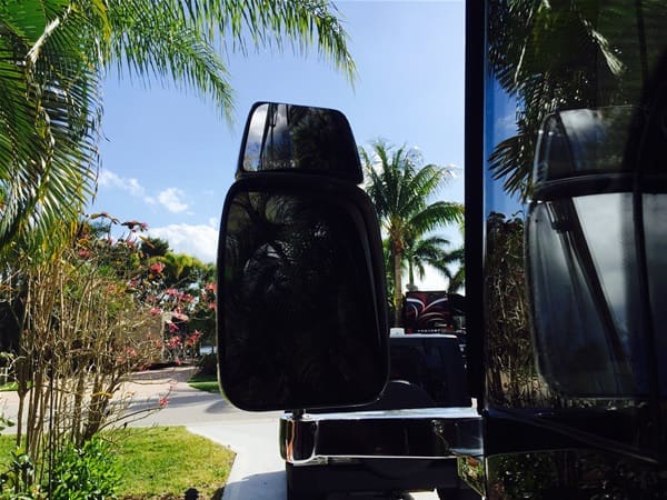

    What would be the correct positioning of the mirror, distance from the window? Would the mirror being closer help with the vibration caused by wind turbulence of our Crapco mirrors? Would a certain position effect the noise Level?
    Has anyone played with this to see if it makes a difference and if so, what was the outcome.

    From the picture, our mirror arm is positioned very close to the side of the coach. I’m not at the coach right now but I think the side of the mirror is less than 6 inches from the driver’s window.
    We do get a little vibration but not bad. We had vibration from our Monaco mirrors also, I would say it’s about the same.
    The position of the arm will reflect the sun sometimes. I was thinking of putting a piece of black tape on the top of the arm to cure the problem.

    I have very little vibration and there might be some reasoning to my madness. I have the mirror itself adjusted all the way over on the outerside of the housing the mirror sits in. If you turn your inside button all the way to the left so the mirror is almost resting on the housing edge I get very little vibration.
    When your mirror is in the middle of the housing it can move all over, by having it almost resting on the side of the housing it has some resistance.

    The mirror housing and arm are rock solid. The vibration from wind turbulence is because the piece of crap mirror is mounted to a plastic motor and gears I’m told, haven’t had one apart. Every bus I’ve owned has this problem.

    road noise because of the mirror position on the driver side of the coach. I
    check with my next door he has a 2013 Liberty, his mirror is one finger width
    from the drive side window. I repositioned my driver mirror, the noise level
    significantly improved.
