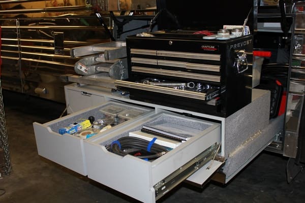

    One thing that has always been an issue for me was the location of the drawer unit mounted at the top of the first bay in a Liberty. I like the drawers, but when the bay door is open the drawers themselves do not extend far enough beyond the bay door to make access to the drawer easy.
    Today I solved the problem and thought I would pass it along to other owners because I didn’t do anything in doing my change that I could not put back to the way the coach was originally built. No special tools, no cutting, just relocating stuff in the bay. My bay photos below will not be like anyone else’s because we all store different stuff, but by dropping the drawer unit down to the joey bed (or the bay floor if there is no joey bed) and putting the other stuff on top of it I can now open any drawer, with or without the joey bed extended and easily see what is in the drawer and get at it.
    My bay is jam packed with the important most often used stuff because the other side of the bay requires me to duck under the front slide. So that side of the bay has the least frequently used “stuff”.
    There is the drawer unit now sitting on the side rails of the joey bed. The Zip Dee chairs are beneath the drawer unit, easier to get at than fighting with the bay door while lifting out the chairs. I removed the chair holders from the bay door so I could move the drawers and my tool chest closer to the outside.
    Even with the joey bed in, I can now open a drawer and easily see the entire contents. No more trying to see something behind the bay door.
    This is a photo with the joey bed extended. I can open my tool chest cover to open the drawers, I can get at my ladder, and behind and below the ladder is my DDEC reader, my wash pail and coach cosmetics, towels, and on the rear behind the tool box are more towels and my safety triangles, my electric drill kit, my drills, screw driver set, my electrical tester and room for a few more things. Those items behind the drawer unit I can reach from the side of the joey bed. The fire extinguisher can be reached and removed just by opening the bay door.
    You can barely see the tool boxes behind the drawer unit but I can lift anyone I want out easily.
    It is hard to see but the drawer unit is secured to the joey bed on both sides with aluminum angles. It is supported from below with three long wooden supports, one in the center between the chairs. The ladder is retained by aluminum tracks on each side just barely visible in the two photos above. That will keep the ladder from shifting.
    Finally I have (after 10 years of dealing with the drawers mounted on the ceiling of the bay) spare parts drawers that are fully useable.

    Nice modification. Looks like it will work out better than if they are hanging from the top. I have one that is top mounted, but it is smaller and not as deep, so it isn’t as much of an issue.
    Maybe you can get Liberty to make a change! You should charge them for a better idea….
    October 28, 2013 at 8:24 pm
    Great idea!
    And, it looks like another plus is that the tool box is now raised so that less stooping is required to access it.

    Paul has quickly noticed the one advantage that I realized after the job was done and that was it brings the tool box up higher making its use a little easier. Liberty owners will notice my tool box has been turned so it faces out and that it does not have the slide so it will extend. My reason for eliminating the tool box slide is because I bought a tool box that is as high as possible so I could bring more tools and testers. In my tool box I have tire repair stuff, a multi-tester, a clamp on voltmeter, an IR gun, a battery tester and the normal range of tools and miscellaneous electrical terminals, fasteners, and bulbs.
    Little by little I am modifying the coach for my purposes, Nothing big, nothing that cannot be reversed, but little things that will work for how we use the coach. Being able to restore the coach to original is important to me because not everyone will want what I want so when the time comes to sell I can return it to exactly the way Mr. Liberty built it with no signs it was ever modified
    My next challenge is going to be to get the batteries out from behind the entertainment center to a place where I can easily monitor and replace them. I’m looking at the space in the first bay behind the driver’s side joey bed. Since that impacts front axle weight I have to be sure I remain under the Prevost limits. That is going to be a big project and I have to make sure I can keep them ventilated as they are now. If I am really lucky I might free up space to add an aux fuel tank, but then again I have the weight issue to deal with so that might not be possible.
