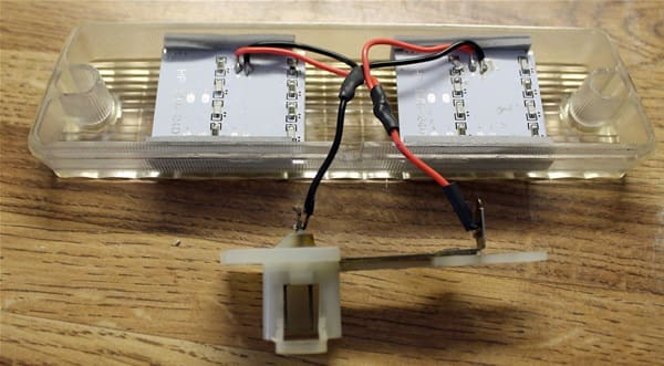

    For anyone interested, I recently changed all of the interior lights (35) to LEDs and decided to change the curb side lights on the coach as well. I have already changed the rear lights.
    This is a picture of the electric brackets provided to me by Gil:
    I went through the process of removing the 12 curb side chrome light fixtures from outside the coach and then at a hobby shop with an EXPERIENCED TECHNICIAN, had brackets made (as shown above) combining two 24 diode LEDs each to be used to replace the single festoon bulb originally in the fixtures. We attached the brackets (combining the two LEDs) by soldering the combined positive wires and the negative wires from the LEDs and then soldering positive and negative added wires to the respective positive/negative posts of the lights and fixture. We then tested each in-house before taking them to the coach. We did have to rewire the lights completely because they came with 24 to 26 guage wire which was impossible to manipulate/solder etc. We increased the wire to 18 guage and it worked well.
    The project to install the interior lights took only about 2.5 hours after I figured out I had to cut about 1/16th of an inch off of the two light extensions before installation in the ceiling recepticles.
    On the outside curb lights, the actual time of removing, rewiring, bracket creation and reinstalaltion took me easily about 10 very intense man hours not considering the various trips to the store or to the hobby shop… The results to me are outstanding….and well worth the effort.
    I got this idea and guidance from Gil on the POG site and his assistance was absolutely excellent….
    If anyone is interested, I am available to provide the issues we encountered. I also thought I was odering 12 lights but instead apparrently ordered 12 dozen… that’s right… I said 12 dozen …and I have the supply to prove it…

    Ron… I have the lights for you if you want to proceed with the way I did them. I am pleased to give them to you if you will tell me your mailing address.(I used two 24 LEDs per light housing …(12 ) light housings total.
    Keep in mind, I took the entire light housing off of the coach and had the brackets shown built by a hobby shop technician. The light wires on the LEDs were too small for working with so we took the wires off of the lights and rewired them with 18 guage. They are now hard wired and are really strong… with no problems so far.
    When reinstalling, it just takes time and patience. They unplug and replug (but the bracket has to have been made and saltered to the positive and negative connections of the housing before installation.)
    Keep the picture provided in this thread to show the technician if you do not do the work yourself.

    There is a “pop-in bulb”…my experience was that it also “pops-out easily”… and isn’t 1/3rd as bright as the system we are discussing. The subject system I installed is hard wired… huge difference. We have 48 LEDs in each light. Sounds like overkill and it definitely is… but certainly works well….

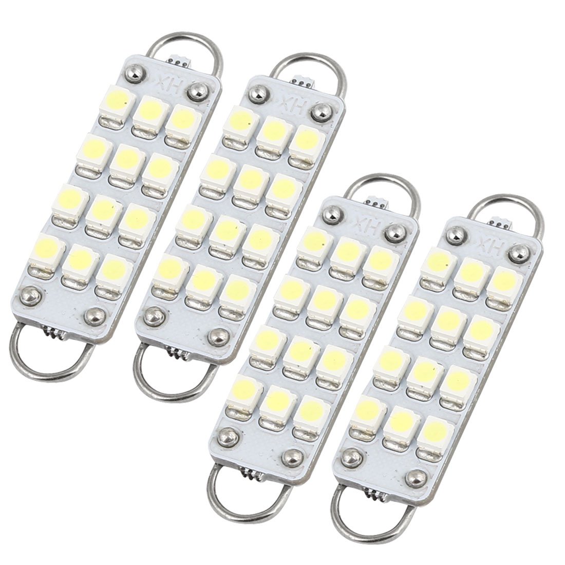

    To add to the discussion… I swapped the festoon bulbs in the cargo lights (port,starboard, & aft) for about $30… I ordered these from amazon:
    http://www.amazon.com/gp/product/B00KYQQM5M
    They are bright…but a bit blue in tint… I would prefer amber to better match the tivoli…
    If I find amber or soft white, I will swap. However, in the interim, they are much better than the old festoon bulbs.
