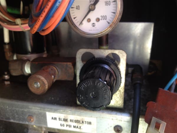

    I am now trying to fix an air regulator valve which is leaking but have not been able to find the parts and was wondering will any regulator do? Or should I find the exact replacement? Trying to post pic with this but have not been able to yet. Thanks in advance. Valve in question

    this valve is under the drivers seat area in the lower door in the steering box compartment.

    What does it control??
    March 10, 2014 at 1:06 am
    Marathon is very good at labeling what this valve is for as seen in your picture along with desired pressure
    Regulator has a number on the back side . The manufacture is most likely SMC. Having replaced several on our bus each one should be replaced with the same internal set up. Remove the regulator to get the part number.
    At this time nearly all have been up dated.
    If you post the existing number I can get the current SMC replacement available. Price under $400
    March 10, 2014 at 8:44 am
    It’s the floor air slide Peter, have you been to the eye doctor?:)

    March 11, 2014 at 10:29 pm
    Thanks for the great information my valve is a norgren and so far I have obtained a suitable replacement for it how ever I did forget to see where the regulator was set at. Any ideas.
    March 12, 2014 at 8:48 am
    Start at a low pressure and keep adjusting it up until you feel the movement of the floor slide is acceptable.
    Too much pressure and the floor slide will open and close with considerable speed and force.

    Ok so I actually answered my own question as I was installing the new regulator and noticed the label which read ” Max 60 PSI” and thought I may need to borrow Peters glasses. Thanks for all the help all is well with the coach for now.
