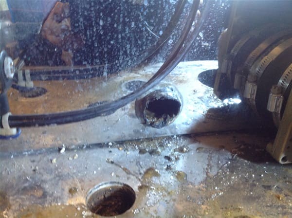

    As been discussed some on other forums aluminum holding tanks fail. These photos are of a holding tank coming out that was not showing any signs of leaking yet. However you can see that it would not of been long before there was going to be a serious problem. That is why we are replacing the tanks with a stainless steel tank. There will be no worries about tank failure in the future.

    Jeff: Its looks like the “bung” that the discharge hose is clamped to corroded in half. I presume that is aluminum too. Is that correct?

    On the holding tanks the nipple goes to a short rubber conector(fernco) then that is connected to the copper pipes…

    My previous 2 Liberty coaches had stainless steel holding tanks. My current one came with the aluminum tank and I changed it out to stainless steel this past summer. I also dodged a bullet because my tank was in immediate danger of failing.

    That picture is worth 1000 words…this was our tank and the decision to replace it was one of my better / luckier ones…some good coaching from Jeff…the incident that tank failure could’ve caused gives me the willies…kinda like the little Dutch boy with his finger in the dike…

    Once again pulled a holding tank today that had been repaired at one of the fittings which was where the Mac unit would pick up from. That repair was holding fine, however the rest of the tank was very bad with small pin holes all over including the bottom of the tank. We could on occasion smell just a hint of sewer in the bay and was starting to see a very small amount of moisture on occasion in the bay. This is a 2000 coach….any aluminum holding tank will fail
    December 2, 2014 at 6:28 pm
    this was on the side of the tank
    Here you can see a trace down the tank with a small hole in the nipple
