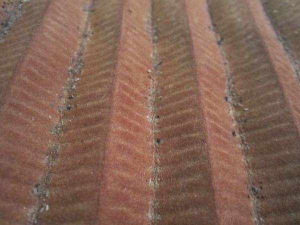

    Opened up a coolant filter in service 12 months.
    About $50 NAPA-Wix part number 4074 with conditioner tablets. Opening the fins up you can see the success in trapping dirt as coolant moves thru filter.
    The filter paper that is on the table in picture #1 is secured around the tube canister inside the filter housing. The fins are about 1/2 inch wide. Filter paper pulled apart end to end measured 6 1/2 feet in length

    I would say that your engine is slowly coming apart and what you think is dirt and sand is actually small pieces of your engine. Your oil filters likely have the same type of debris.
    In planes we usually ignored that stuff until the filter started trapping pieces big enough to have part numbers on them.
    Just kidding.
    I would guess, but do not know that if you did that when the bus was brand new you might have had enough to fill the average sand box. I believe our blocks and maybe the heads are sand cast and as much as they try to clean all the passageways and galleys it is almost impossible so over time you catch that which the manufacturer of the engine block was unable to clean out. Aren’t you glad you don’t see that in the oil filters? I open my oil filters and open the pleats and run a magnet across them. Fine particles of steel and iron will show up if you do that and your have a problem. I also inspect the drain plug because that is a magnet and also shows up particles. I never opened my conditioning filter.

    Actually the suggested list on that filter is $58.68. This is a easy do-it-yourself change.
    Soooo….. PC members use your NAPA card.
    This 4074 filter is at the high end capacity coverage and contains the conditioner pellets.
