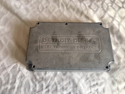

Monday, Brad decided to go to the bus, remove the ECM (Engine computer) from my bus and have it read remotely. He found that Burroughs Diesel in Laurel could read it so he brought the ECM to church Monday night.
I took it to Burroughs Tuesday morning and the technician took it in the shop to read it. He was back in the office in only a few minutes and he told me the ECM was good. What?
I ask him if there was any way to read any codes it had been throwing so we could have something to go on. We were lost without some information on the ECM. He said he could probably do that.
He was gone 20-30 minutes that time. He booted up the ECM and began searching through the information when the ECM shut down. He tried everything in his bag of tricks and the ECM never booted back up.
When he brought it back he said, “You were right, the ECM is bad.” I had been dealing with Curtis at Burroughs and he took me in to see Leon the parts guy. Leon got right on it, knew exactly what he was looking for and had a new ECM on the way in moments. It would arrive the next morning.
The existing ECM was installed on our bus the week we purchased it in March 2008. The old one had a problem and the seller replaced it before we drove away.
Wednesday morning I took the old ECM back to Burroughs. They were hoping it would boot up one more time and they could download the programming for my engine from it. It was dead and would not arise. It is my understanding that they downloaded the programming from Detroit. I gave them the numbers for the new fuel injectors and they said they would program those numbers in as well.

Thursday morning brad met me at the bus and installed it. Most of you know, but for those that may not, the ECM mounts down low in the passenger side of the engine. This is the fuel line going into the primary fuel filter in front of the ECM.

Brad hooked his diagnostic computer to my bus and the ECM came right up.

For those that would like a place to diagnose and rebuild your ECM, ECM King in Santa Fe, TX has lots of experience doing just that. Diagnose is free. Rebuilt my dead logic and dead power board for $1000. My Cummins M11 is going again. Detroit, Cummins, Mack, International and Allison ECMs fixed with one year unlimited mileage guarantee. They even have a box loaner program.
ECM King, 6421 Hwy 646 South, Santa Fe, TX 77510
409.927.1800
You can send ECM to them or drop by and they will diagnose ECM in the bus.

That is the $10,000 question, Jim. I have talked to Brad and Jeff about that. I watched Mark from Mid Coast Diesel in Houston push on the wiring harness with his fingers and cause the engine to run so rough it was about to die. That and the original code from the ECM and the Detroit Monitor make me think the wiring harness was indeed bad.
Did the bad wiring harness also short something in the ECM? Did something in the R&R damage the ECM? I will probably never know either one of those things for sure.
I am interested in educated or experienced opinions though.
One thing I do know for sure, the shutdown I experienced that led to the repair AND the glitches that I experienced after the first repair had ever happened to me before in this bus. I hope to God they are over.

Burroughs Diesel in Laurel was about $1750 for a remanufactured ECM plus one hour labor for the programming. It would have been $600 more without the core. That was less than I expected. When the ECM was replaced in 2008, it was not on our tab. We were told the price by the guy from Detroit, but we failed to make a note of it. My wife and I both have $2200 in our mind as the price then.
