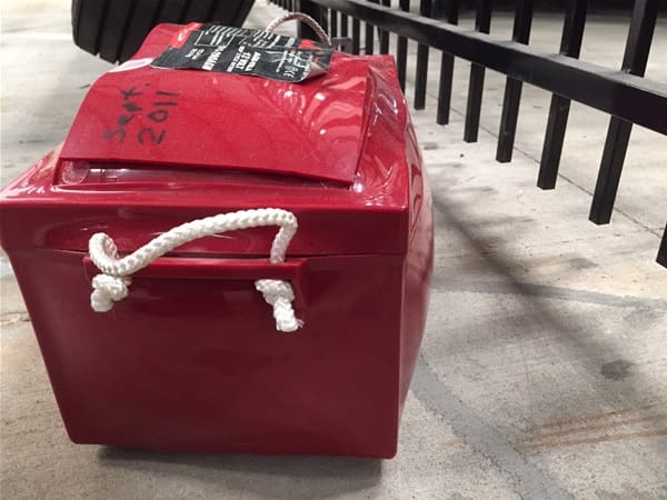

    I’ m a new Prevost owner, a new to us 1999 Marathon XLV. After having a prebuy inspection done at Marathon Grand Prairie, TX and most everything comming out ok we are having a few things done before we go on our firs trip. We are having wood floors installed and found that the previous owner had two batteries installed for a total of 6, four in the battery bay and 2 installed under the bed. When the floor installers raised the bed to get to the carpet they were removing, they found the 2 batteries under the bed. One looked like a beach ball, about to explode. I’m having these 2 removed for safey reasons, as you might imagine, now my question. Will the factory 4 batteries surfice, having enough power to run the bus, using the inverter’s to power the loads, as long as you don’t go crazy, like running the A/C’S off the inverters. Any insight is greatly appreciated.
    This is what was found.

    Mark: One battery had expanded and the other battery was OK? What kind of batteries are those (make and type of construction)?
    Maybe a knowledgeable battery person will chime in and give us some insight into what might have caused the battery to expand like that.

    I don’t know for sure but here is my take looking at the pictures. The battery was probably fine under bed compartment in the beginning but I question the mind set of the installation.
    Due to the heat generated by the engine it slowly cooked the electrolyte out of the battery to a danger level once it went under the top of the battery plates. I do not see any filling holes on the exterior of the battery case. There are vent caps under the top roll over shell.
    At some point when the liquid level goes danger level below the plates we now have a cooking battery which gets hot. The temp rises to the point where the case is expanding as it cannot vent the gases produced.
    Why these did not explode is the $64000 dollar question. Luck and having a lot of it prevented an explosion and then a fire.
    You are very lucky to find this time bomb before it changed your life. Over 14 years of RV’s and buses this has to go right to the top of the list of odd and “what in the hell was someone thinking ” ?

    You need to determine what device was charging those two batteries and if the same device is charging your other 4 house batteries. It looks like the red batteries were severly over charged, overheated and expanded. If it is your inverters that charged the red batteries, check the charging settings in the inverter. Have you visually inspected the other 4 batteries to make sure they are not swelled up?

    Your Marathon Coach was originally designed and built with a quantity of 6, GPL-4DL Lifeline batteries. I do not recognize the red batteries that you show in the pictures. I strongly recommend having the original Lifeline batteries re-installed. Also, make sure that the temperature compensation sensors are installed and functioning properly after the battery changeout. This will get you the orginal longevity and performance out of the system.
    Skimping now, as a previous owner did gets you nothing but problems. Cheap “knock-off” batteries, or incorrect type of batteries, installed in unsafe locations like inside the coach interior, can be not only illegal from a vehicle manufacture and service standpoint, but also for very good reason could result in personal injury or worse. take the time/expense now to get the batteries back to original configuration and type. You will be glad you did! Just my two cents worth….

    Yes Marathon did see the batteries when they did their inspection saying that it look like a good installation but wasn’t the norm. I wasn’t big on the idea but thought I might be able to live with it since the last owner had. The other items Marathon found, was that the jump start feature had been disconnected and the previous owner had some wiring put in, to charge the engine batteries when the bus was plug into shore power. Since the batteries were not being temp compensated for, they were cooking themselves and boiling off the water. This was all corrected before we bought the coach, and the jump start feature as well as the other wiring items was put back to factory, at quite an expense to the previous owner. I think that we will be ok after this fix, just at my expense. I won’t try to run the cruise air’s of the batteries even thought the manual says it can be done. All of this will have a steep learning curve, but with help of the experience and thoughtful people here, we are going to figure all this out.
