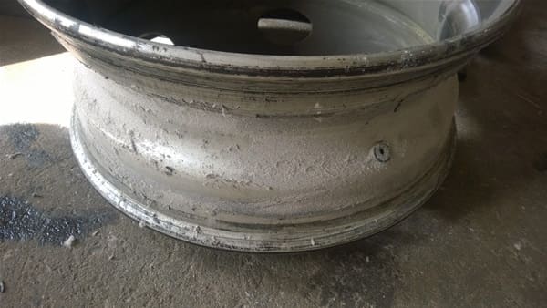

    So I got tires put on last June. Without my knowing, the shop put the balancing powder in the tires they were doing (2 steer and 4 drive tires). At the time, they failed to install the proper valve cores. This was an issue as I found out why they need the special valve cores as I was 3000 miles away from where I had them installed.
    Got back in late summer and had the tire company come out and “fix” their issue with new valve cores. This worked, but only for a while. Found that one of the front steer tires valves was gummed up again and wasn’t holding pressure when I removed the cap (this is another reason to have metal caps with seals, or pressure sensors with seals, it’s one last safety measure to keep air in your tires is the cores fail).
    So to get the problem fixed for good, I am now at C&D Tires up by East Tennessee Luxury Coach getting all six tires unmounted, the balancing sand vacuumed out, rims cleaned and new valve stems installed.
    So if you are getting new tires put on, make sure to tell the shop not to use the “magic fairy dust”! It’s not worth it and it doesn’t work. Oh ye, that’s right, even with it the tires were never “balanced”.
    Spend the money and get centramatics installed on all three axles. They work and dont interfere with the valves holding air.
    Pics of what the mess is.

    Isn’t the tire installer supposed to put special screens on the inside of the wheel to keep the “magic dust” from interferring with the valve stems? Was this not done? Or was it done and one or more screens failed to do their jobs?
    By “magic dust” I presume you mean “ceramic beads”. Correct?
    I had new tires installed at Jeff’s last April/May and the beads were put in. I think by C&D. I presume it was done correctly.
    April 18, 2015 at 12:11 pm
    Dick, The original place put in standard stems and cores. The cores that are supposed to be used, have screens on them to keep them from getting the sand into the actual core.
    The first round of failure was that the cores were getting jammed up and leaking due to the incorrect cores. They replaced the cores after I got back from my trip. However those cores are now starting to fail. not sure if the stem is supposed to be special or not. From looking around on the internet, I could only find specific cores for the balancing powder.
    This is a fine dust like powder. comes in a plastic bag that the bag (two actually) are put in the tires at time of mounting the tires. As the tire rotates, the bags break and the power is supposed to “balance” the tire as you are running down the road. besides the powder causing the valve cores to fail, the powder never did what it was supposed to do. The tires gave a VERY rough, unbalanced ride.

    If you had Jeff/C&D do the work, then I would bet your have centramatics and that’s the best way to go. As I mentioned C&D wont use the powder unless it is asked for. and I think they use something that isn’t as fine as the stuff that was out into my tires.
    Part that really sucks? is that I now need to pay a different shop to fix the first shops screwup/failure.
